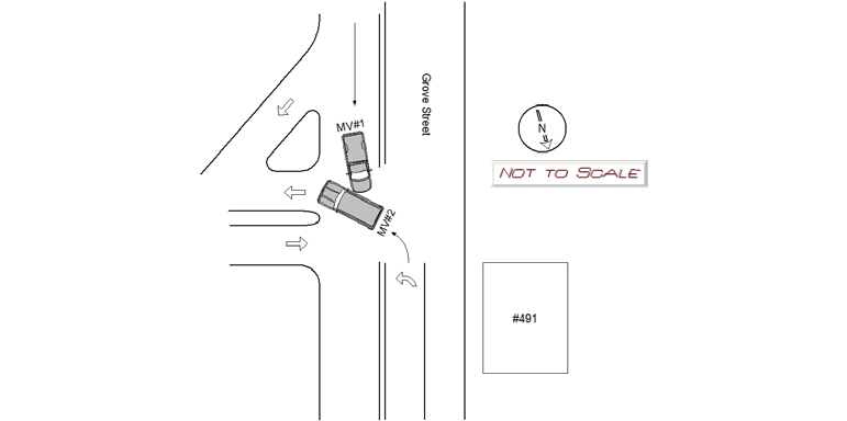

2000000699
2020-12-03
15:19
491 GROVE ST
The OP. of MV#1 states he was traveling northbound on Grove Street when MV#2 suddenly made a turn in front of him. He tried to swerve away but they still collided together. The OP. of MV#2 states she was traveling southbound on Grove Street and didn't see any oncoming traffic. She proceeded to make a left turn and then collided with MV#1.
42.3321163
-71.2568997
491 Grove St, Newton, MA 02462, USA
